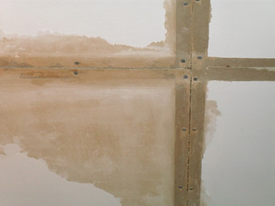

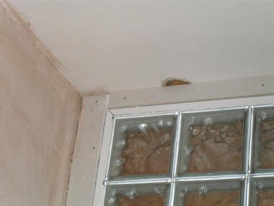

    Postby Sheila Lit » Sun Feb 20, 2011 5:33 pm
    Hope the photos help, as you can see hardboard ceiling, we have removed the old paper tapes (the kind that had a few ridges down the middle). The paint has come off in places where there has been some water damage in the past we think. The third photo shows there is 3" from the ceiling to the top of the white sleeve of the glass blocks. We will be edging around the glass blocks with wood (architrave) to finish it off. So we were hoping we could just retape over the joins on hardboard with paper tape, them probably undercoat the patches where paint come off then just re-paint over the full ceiling. My husband can't seem to find the paper tape that they used to use with the ridges down, i think he would prefer that type, or could we use any paper tape that we can just stick up and not have to use filler over the top of it, where do we get it from?Thanks again.

    Postby chris_on_tour2002 » Sun Feb 20, 2011 10:55 pm
    are you absolutely certain that it's hardboard? it seems highly unlikely to me. it's probably the old fibreboard that was used for a time after lath and plaster went out of fashion.

    Postby Sheila Lit » Mon Feb 21, 2011 7:27 pm
    Yes, it's definately hardboard. We've come across a lot of bodged jobs in the past in this house!

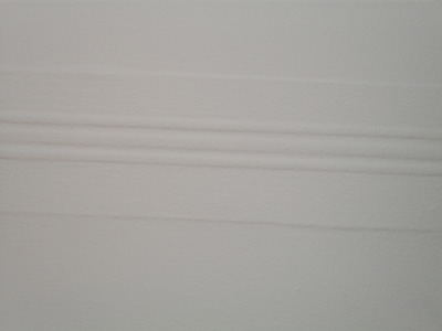

    Postby Sheila Lit » Wed Feb 23, 2011 6:03 pm
    Above is the actual tape we have been looking for to replace the tape we took off, it has three ridges down middle. Can't seem to find it anywhere! Does anyone know where we can find the above tape that we can just put on joints then paint over ideally.Many thanks.
