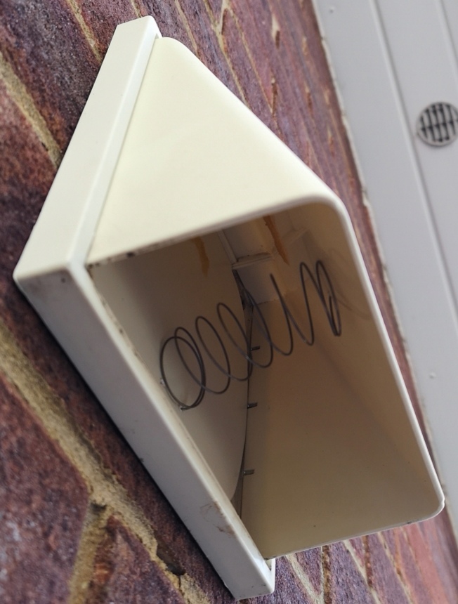

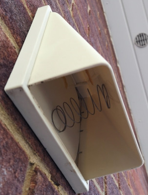

I've mastered the FIX on rattly extractor fan vent! I'm living in total utopia PEACE AND QUIET RULES ONCE AGAIN!
Right.....the fix, you just need a weak spring and a hot pin.
Remove the cover plate and flap...and heat a pin on the hob and push through the casing and the flap...now thread through the tips of the spring and bend over to prevent it from coming out again...reassemble and hey presto....SILENCE! And when extractor is on it overcomes the spring and works a treat!
(Picture attached)
Thank me later guys! Your welcome....enjoy your sleep!
