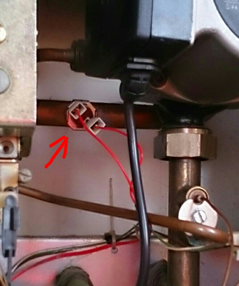

Postby ccoops » Thu Apr 23, 2015 4:22 pm
I know this post is very old now but anyone coming here hoping to find a possible result will be disappointed so having had this same problem and having resolved it I thought I would add my twopenny worth.
On the central heating flow pipe that runs horizontally across the back is a thermistor that is only held onto the pipe with a spring clip. This thermisitor needa to be seated properly on the pipe with heat sink compound, the pipe has been flattened where the thermistor seats. I had to bend the spring clip on mine to make it hold the thermistor in place correctly. This solved the problem for me and the domestic hot water pipe never got hot anymore.
I guess the feedback from this thermistor is used to determine the gas flow and modulation.
I am no expert on boilers, just trying to save myself buying a new one when this one works fine, mine is 14 years old now and still going strong.
I hope this is of some help to others.
The thermistor in question is the item that the badly drawn red arrow is pointing at.
