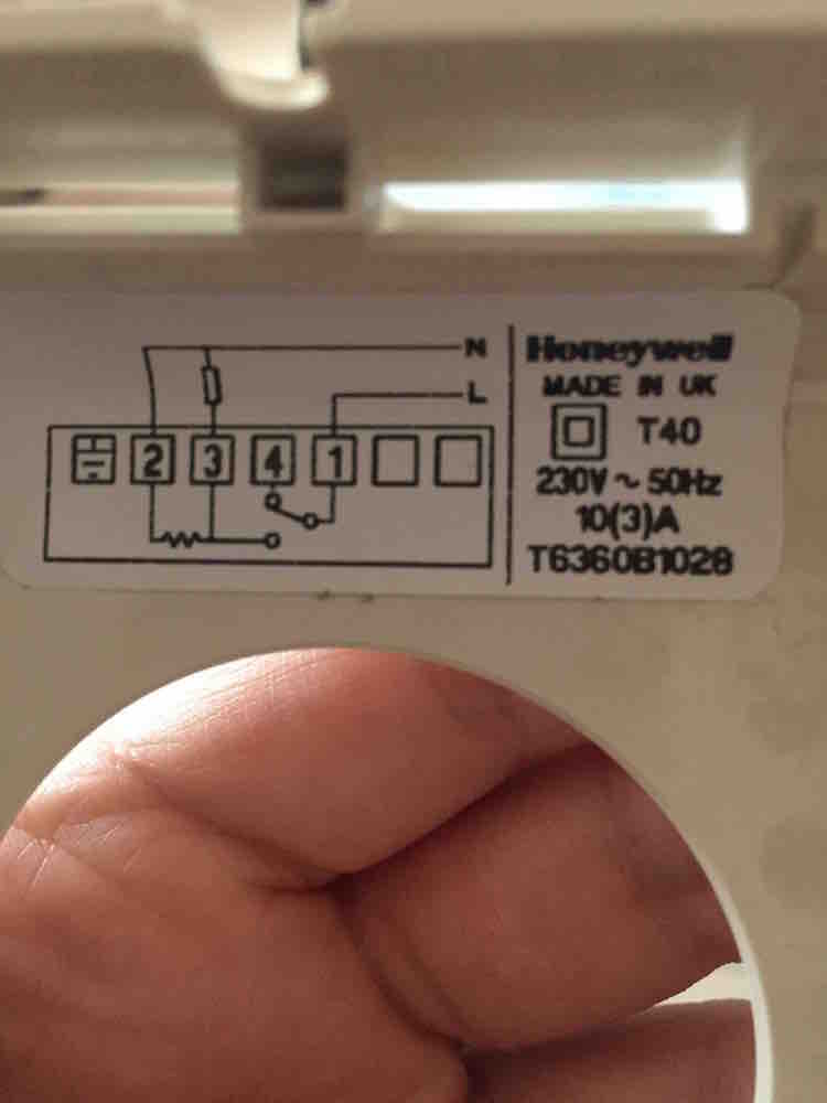

Hi, I'm replacing an old honeywell dial thermostat (T6360B) with the DT90E.
The old one surprisingly has 4 wires:
Yellow/Green to earth
Brown to T1
Grey to T2
Black to T3
The DT90E has A/B/C terminals. Can someone help with which 3 wires go where and which is redundant.
Thanks for any help.
Pics attached.
New Thermostat diagram
Old Thermostat diagram
Old Thermostat wiring

Your new stat does not need a neutral or an earth. So make the grey and the green/yellow safe within the housing. Connect the brown to A, and the black to B.
