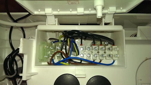

Salus RF Unit 4 connections
L N COM and NO, I assume NO = Normally Open in rest state and Live when heating is wanted ? COM = live all the time ? presume from one side of the wiring block in the boiler ?
Picture : of the Programmer RF Unit
The Wiring Block on the Boiler and the Wiring diagram printed on the cover
I was expecting to find a link wire in the block for the external thermostat but its not obvious or is it me ?
many thanks in advance Eric :)

The problem here seems to be the boiler diagram. I think you'll find that your boiler was made by Vokera, as Compact HE. Try Vokera's site.
http://cdn0.vokera.co.uk/wp-content/upl ... manual.pdf
The wiring diagram is somewhere near the bottom, and includes a room thermostat,

Thanks buddy, that diagram is of a better quality and I can see the word COM so as there's only one wire left it should be simple.
Many thanks for your help
