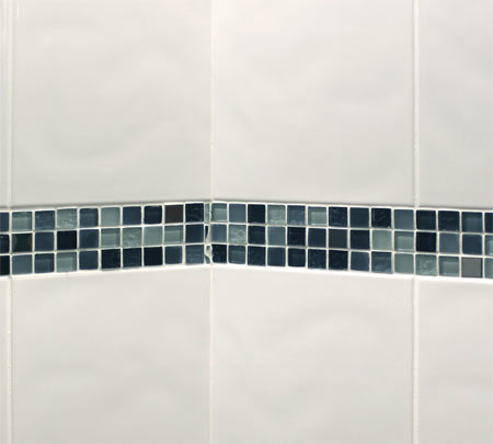

Shapes and Layouts for Your Tiles
A plain square layout can be broken up with a border of feature tiles – thin rectangular or small mosaic tiles of a contrasting colour.
Bathrooms often use large rectangular tiles – most often in a portrait position, so that the rows are higher than the width of a column.
Smaller rectangular tiles (even down to mosaic size) can be used in a brickwork pattern to great effect.
White tiled wall with border
White tiled wall broken up with border – Image courtesy of the gbtilesbathrooms.co.uk
In the image below you can see that with a little hard work, well, quite a lot of hard work, you can create some great effects using different coloured tiles. A good point to note if you are thinking of going down this route is make sure that you plan your design first and also mark it out so that you know exactly where the different coloured tiles and more importantly the different sized tiles will go.

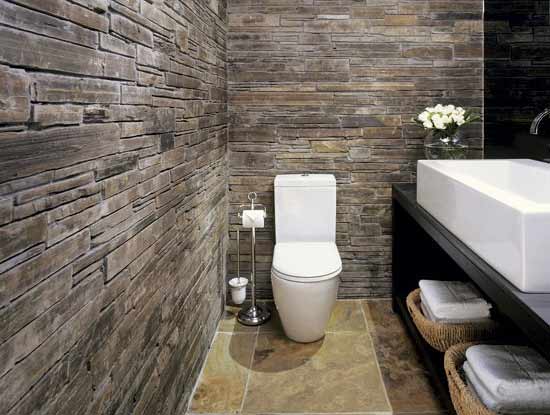

Textures and Finishes
Modern or rustic, high gloss or matte? There are a number of different finishes to choose from. Ceramic tiles can be made to look like stone, and a nice country style kitchen will look very good with uneven, rustic tiles to match.
Bathrooms are more likely to suit a high gloss finish, as it will reflect light to enlarge the room. If you have a large room though and want a warmer feel, choose a matte finish.
Keep in mind who is going to be doing the tiling – if you are planning to do it yourself, then some tiles are much easier to cut and grout than others.
Vitrified porcelain tiles are very effective and can look just like stone, but they are impossible to cut without a good wet tile cutter. Rough and rustic tiles look good, but they are much harder to grout (and clean!) than a nice, smooth finish.
Rustic and natural tiled bathroom
Smaller bathroom tiled with natural, rustic looking tiles – Image courtesy of the housetohome.co.uk

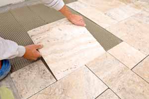

What to Think About When Choosing Floor Tiles
Floor Tiles and Sizes
It is generally held that smaller floor tiles will make a room look bigger but if you lay small format tiles on a very large floor, you can find that the lines make your eyes go funny!
Larger tiles are generally used in kitchens and conservatories, but bear in mind, as with wall tiles mentioned above, larger tiles require a flat floor otherwise you will have very unsightly joints.
You might think that the floor should be flat anyway, but you’d be surprised at how many floors are uneven, particularly in older buildings.
When it comes to budget, you will probably find that the cheaper tiles are a standard 30cm square. Mosaic tiles can work out very expensive, and unless you are tiling a wet room, would not normally be considered for floors.
