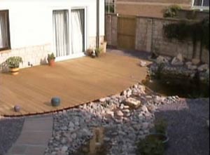

Finished garden design after complete garden makeover
Finished Garden Design with Decking, Summer House, child’s swing, path, stream, waterfalls and pond

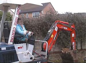

Once we had our plan, the first step was to get some help. For those who are concerned; this little lady was not really the digger driver………..She was the BOSS!
Mini Digger and driver
Mini Digger and Mini Driver – A mini Digger will fit in most Gardens and makes Garden Landscaping much easier

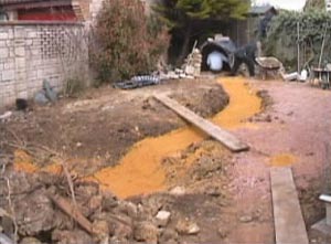

Dig out the pond and lay sand to protect the pond liner
We Dug out the pond and laid sand in the hole to protect the pond liner
Dig out the Stream and lay sand to protect the liner
We Dug out the Stream and laid sand in the stream bed to protect the pond liner
The sand is a precautionary measure against stones puncturing the pond liner. We also used pond liner underlay, but the sand is an extra measure to prolong the life of your pond liner and as mentioned before, we only wanted to do this once!

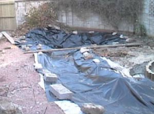

Lining a pond
Now to line the pond and stream: We used thick heavy-duty pond liner laid on top of pond liner underlay. Again do not skimp on the liner, especially if you have children. It needs to be really heavy duty, because they will not be able to resist a little paddle, and even with the sand and liner protecting it the thinner the liner the more likely it is to get damaged or split.
We created the holding pond especially so the children can paddle. Together with the cave, there is much fun to be had in there. Before we lined it, we built a paving stone bench inside and applied another coat of render, which we smoothed with a sponge. This is now being covered with a beautiful array of "cave paintings"!
Pond Liner from the Steam to the Pond
Pond Liner from the Steam to the Pond – Pond Liner should be Laid From the Lowest Point to the Highest to Prevent leaks
Pond Liner from the Pond to the Stream
Pond Liner from the Pond to the Stream – There is sufficient Overlap of the Pond Liner to Prevent Leaks

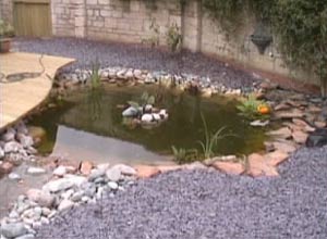

We laid the liner for the ponds and the stream with a foot (300mm) or so overlap which will later be covered to hide it. Having some extra lining ensures that when the water is in, weighing down the liner, that it is still a little higher than the level of the water to prevent water logging the garden adjacent to the water features.
When the liner was in we had to fill the pond for the first time. This allowed the liner to take the shape of the hole and settle to its lowest level. Make sure you do this before you do any work on hiding the edges of the liner. Were you to set any edge stones first, when you then fill the pond the weight of the water will pull on the liner and move everything around the edge. Make sure you allow enough liner for this movement to happen without leaving you with a liner edge only halfway up the pond sides.
Filling the pond at this point also gave us the opportunity to test the pump and the pipework we had buried along the back wall of the garden and up over the cave roof.

Fill the pond and test for levels
Filling the Pond to Test the Liner and allow it to settle

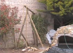

Rope Swing Frame Attached to the Garden Wall

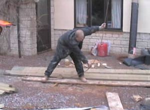

Building a Deck

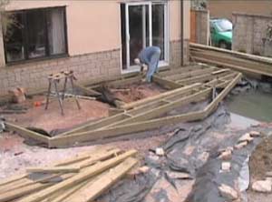

Time to start the decking: Not a complicated process, although the levels need to be spot on. Make sure all the timbers you use are treated to make them water resistant, and that they do not come in contact with the ground where they will sit in water.
You will see from the close up, we installed damp-proof membranes and weed fabric under the timbers for the decking frame, and chocked them up on a small wedge, wherever possible, to help protect the timber from moisture as much as possible.
If, however, you already have your decking timber and it is non-treated or only partially treated you can retrospectively treat it against moisture and insect attack with several products available on the market such as a boron-based powders and gells and also boron rods. For a little more help and information on decking and treating timber decking give Property Repair Systems a call on 01626 872 650. Any advice will be free of charge and with no obligations
Deck Frame is Protected with Damp Proof Membrane and Chocked up
The Frame for the Deck is Protected with Damp Proof Membrane and Chocked up to prevent the Timbers Rotting
The Frame for the Decking
The Frame for the Decking Allowing an Area to Extend Over The Pond

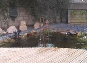

The Finished Deck
The Finished Deck with a Curved Edge

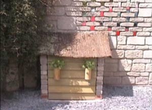

Summer House
Now it is time to show you how we put the summer house up. It is a simple four post construction, concreted into the ground.
Summer House
Summer House with Hipped Roof and Bamboo Doorway
The hipped roof was cut to take plain tiles with bonnet hips for an attractive, almost oriental roof line, to offset the bamboo doorway.

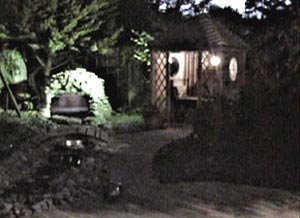

We also fitted a light which is controlled from a panel inside the house, plus an external electrical socket. Sorry it is not the best picture in the world of these two things!
Thatched ceiling to hide the roof tiles
The Ceiling was thatched with Heather Roll to hide the Roof Structure
We have to admit this is not the clearest picture in the world either, but you may be able to see that we "thatched" the ceiling with something called Heather Roll or Heather Screen. You will see some more on the "pump house" later.

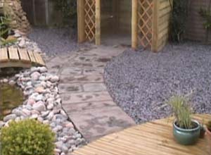

The Paving Stones match the Garden Path
The Paving in the Summer House Matches the Garden Path
The floor was paved at the same time and with the same paving slabs that make up the garden path. This curved path then leads the eye along it and straight into the Summer House, making a natural focal point for the garden. Distracting the eye from the long expanse of fence and leading it towards the water features and the cave.

The pump house went up next. This contains a UV standard filter for the pond, which has it’s own separate small pump. The water is pumped from the pond, through the filters and straight back into the pond.
Pump House with Thatched Roof
The Pump House Houses the Pond Pump and Filter System
The pump house has a concrete base and stone walls which match the existing garden wall; the front lifts off to expose the filter unit. The roof was made from marine ply, covered in roofing felt to make it waterproof and then ‘thatched’ in the same Heather Screen we used for the inside of the summer house roof, to soften the effect.

We used paths to define walkways, and crushed slate was introduced as a ground covering (with weed control fabric beneath).
Path Stream, bridge, play area and shingle
This picture shows the different materials used in the garden design to give a selection of textures and colours in the Cave, Path, Stream, Bridge, Play area and shingle
Path Stream, Bridge, Deck, and Shingle covering
The Curved Path Leads to the Summer House From the Deck and Encourages you to explore the Garden further by leading you over the Bridge
The edges of the ponds were covered with stone, the stream bed was lined with gravel and pebbles were placed along the stream bed to define the edges and to cover the edges of the liner.
Make sure the stream bed looks good when the stream is empty, that way you do not have to run the pump for the steam all the time, but only when you are around to appreciate the sight and sound of the running water.

The Pond with Plants getting established
The Main Pond with Plants getting established
One side of the pond has a very shallow slope to encourage wildlife to use it, and to prevent hedgehogs and other small creatures getting stuck in the deep water. They are great swimmers but they need a slope to get out!

We decided to add a handmade copper water feature into the middle of the pond. Fountains and waterfalls aerate the water which is good for all freshwater fish.
Copper Fountain
Copper Water Feature from Bent Copper Piping
Fountains and waterfalls also give a lovely sound of running water which can help to mask other noises such as traffic noises.
Copper Water Feature from the Deck
Copper Fountain from the Deck
All the different water features can be turned on and off independently of each other to give total control of the effects of the water in the garden.

Garden by Night – Garden Lighting
Lights were placed under the deck, inside the cave, in the summer house and on the garden fence to illuminate the cave and the waterfall. The lights are all operated individually and are on dimmer switches all operated from inside the house so they can be individually and easily controlled. (More bad pictures, sorry about that – we are builders not photographers!)
The cave, waterfalls and summer house lit up at night
Garden lights Illuminate the cave, waterfall and summer house at night
We took the greatest care in picking the lights and installing the outside electrics to make sure they were perfectly safe. You can see a video about installing garden electrics and garden lights in the video at the bottom of the page.
