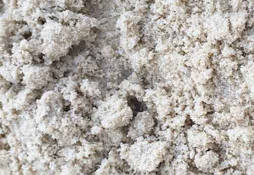

Builders Sand – (aka River Sand, Screeding Sand, Plasterer’s Sand, Mason’s Sand or Bricklayer’s Sand)
Unlike the sharp sand above, builders sand is much finer due to the fact that the grains are much smaller.
In terms of the grains, unlike the coarse sharp and angular grains that make up sharp sand, the grains found in builders sand are much more rounded and smoothed off.
As the grains are smaller and smoother, this results in a much smoother overall finish hence the reason builders sand is used in screeding and plastering applications.
As the name suggests (e.g. river sand) this sand-type is normally collected from the beds and banks of rivers or from around more inland water sources as, again, the presence of salts and other organic matter needs to be kept to a minimum to ensure that atmospheric moisture is not absorbed that could then cause damp issues.
In terms of colouring, builders sand normally tends to be a light grey colour and can in some instances appear almost white.
In summary, builders sand should be used for:
