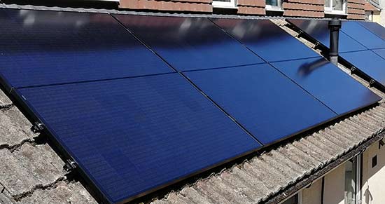

Monocrystalline Solar Panels
Widely regarded as the best type of solar panel at present, the monocrystalline solar panel is the most efficient type of solar panel, has the greatest output and generally regarded as the go-to option for domestic installs.
One other feature that makes them popular is their appearance. Unlike polycrystalline panels that have a blue colour to them, moncrystalline panels are mostly black which many regard as being much more in keeping with the look and feel of their property.
They’re efficiency is very much down to the way in which they are made. Unlike polycrystalline panels that use silicone crystal fragments, moncrystalline panels are formed using a single crystal seed.
A single silicone crystal seed is placed in a high temperature vat of molten silica and then the seed is slowly withdrawn, allowing the silicone from the vat to form around it.
Once cooled this large crystal is then cut into extremely thin slices and these are then used to form the cells that make up a panel.
Producing solar cells from a single crystal will allow the electrons to flow with much less resistance than using fragments such as with polycrystalline panels.
Although the price and efficiency gap is closing between moncrystalline and polycrystalline panels due to advancements in technology, monocrystaline panels are still the preferred choice at present.
Monocrystalline solar panel install on roof of property
Advantages:
  • More efficient than other types of panel, some up to around 24%
  • More efficiency means a greater output with less panels, ideal for smaller roofs
  • Less affected by higher temperatures
  • Great lifespan compared to other panels, some feature a 99 year lifetime guarantee
  • Aesthetically pleasing to the eye
Disadvantages:
  • Cost more than any other types of panel

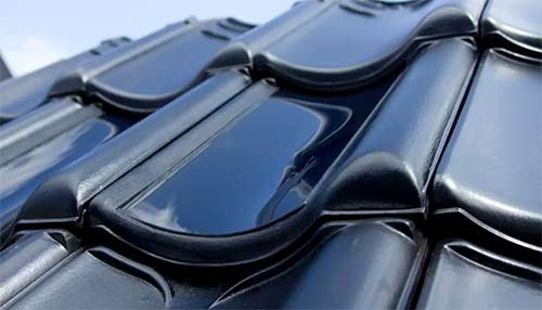

Solar Tiles
Again, solar tiles are a fairly recent development, although the concept has been around for a while, it’s just taken a little time for the technology to catch up, although they still have a fair way to go.
They’re main benefit is that they can be produced to mimic pretty much any type of roof tile or slate so can directly replace the slates or tiles in an existing roof, making them more versatile than standard solar panels and ultimately more visually appealing.
However as the technology is still not fully developed (Tesla are currently leading their development) solar tiles are generally not as efficient as standard solar panels are are also much more expensive.
Solar roof tiles
Solar roof tiles – Image courtesy of flexsolsolutions.com
