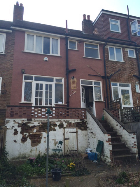

We would like to remove an old coal bunker and build some wooden decking in its place in the garden of our 1930’s terraced house. We would like extend the decking area out to the 3 metres of our permitted development. Due to the topographical characteristics of the land surrounding the house however, we are unsure whether it can be done on permitted development or whether planning permission is required.

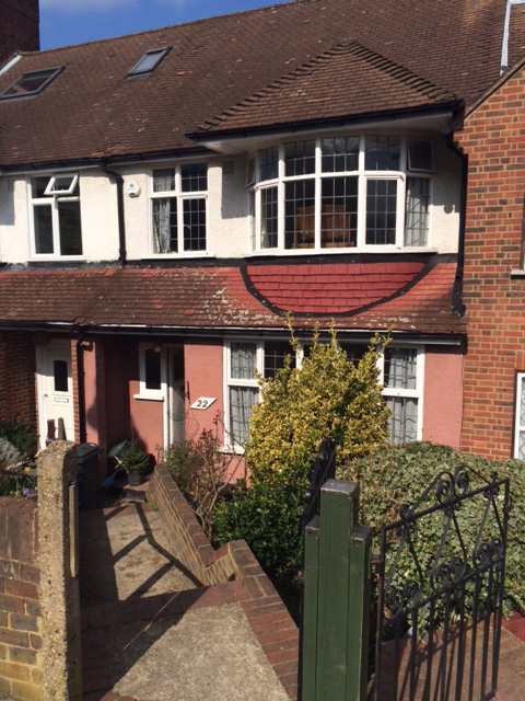

The land slopes from front to back with the pavement at the street level significantly higher than the back garden. Steps run down from the street level to the front door and also from the roof of the coal bunker at the rear down into the garden.

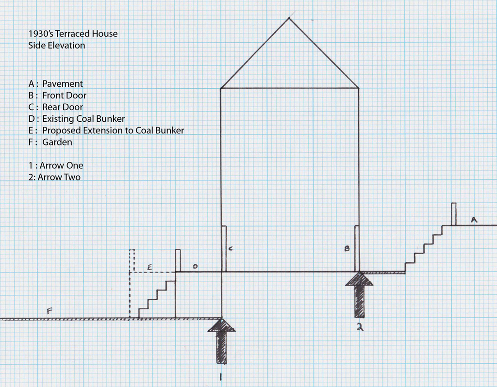

With this message is a diagram of the side elevation of the house and a few images to help with your understanding. I have positioned two arrows on the diagram to show where I think ground level might be. I feel that, from the information I’ve read, ground level is at the arrow marked ‘2’. I am concerned however that it may actually be at the arrow marked ‘1’.

you will need planning consent, the council require a plan of your intensions and will grant or deny it, based on drawings you submit, you need to include a basic plan of your house, from a birds eye view, the proposed height, direction (north, south etc) the materials you plan to use handrail height, and what the finished project will look like
