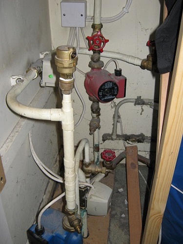

Hopefully the pic is clearer. In a Bungalow just to clarify.
Airing cupboard in Shower room.
The red pump at back is a 'Danfoss' and nothing to do with central heating. The top gate valve is closed turns about 1/2" (play) then stops dead. Bottom don't know if its on or off same thing can't turn it. Haven't a clue what its for I don't think it was for the old shower. The top pipe was entering the side of old tank now In top of new tank. Kitchen 33mts away but can't see its for that otherwise I'd get no hot water.
Am I correct the two white boxes in the pipework are motorized valves but why two in same system when its not separate. Top is Sunvic bottom one in vertical pipe is a Satchwell.
Brass fitting in blue c/h pump pipe believe to be auto air expeller.
however looking at the pipework it appears a bad DIY job.
Perhaps being too harsh as not being trained done better with water not gas which I wont touch, can but won't.

Back to your airing cupboard. - Yes the two boxes are motorized valves. Satchwell and Sunvic are the same manufacturer (they changed their name) the bottom one is quite old, and of a type that motors both to open and to close, most are spring return these days, top one could be, but can't tell from the photo. I would expect one is for heating, the other for hot water, being controlled via a cylinder thermostat.
The pump at the back is a Grundfos, not Danfos. the brass thing is indeed an auto air valve.
Unfortunately I can't, from the photo work out what way the pipework is connected, what is tee'd off what, or what the pump at the back is doing. I see two gate valves at the top, do you mean the one on the pump supply ? The one at the bottom, if it is on the pipe from the bottom of the cylinder is a balance valve, and is used to prevent the hot water 'robbing' the heating. It'll be set, so don't try to move it.
The installation doesn't look that bad, I've seen thousands worse, and I do mean thousands. I can't say a lot more without loads more info. The only thing that may be suspect is that Satchwell valve, due to it's age.

Thanks propTech will take some more pics there seems to be more gate valves in the system than the local plumbing shop. I'm going to try get better photos.
The Grundfos pump is fed from top of the tanks(from the side of the old tank) engineer fitted it to the top of the new tank. The outflow from pump through floor and goes I know not where. I don't think it ever worked since we moved in in 2004 something I should have but didn't check. Couldn't trace it when the floor had to be replaced as no room to get under the floor all pipe work in the way and did not want to remove the insulation as it would not have bee easy to get at it properly. So am resigned to leaving it alone as long as no leaks appear. Can't be for kitchen 33mt away as I thought because the pipe feeding in the top(flow in) is hot. the pipe below (out flow from pump) is cold so I am assuming both gate valves are.
