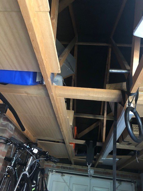

Loft boards for storage.
That's how the current boards are (pieces of timbers that don't go all the way so the middle bit is empty for access)
https://www.diynot.com/diy/attachments/garage3-jpg.147356/
What would you recommend to put for loft boards ?
Happy with the current material however as I said it doesn't go across.
But options that I am thinking
A)Timber board
https://www.wickes.co.uk/Wickes-PTG...g ... 0wodWdgFcQ
B) Chip board
https://www.wickes.co.uk/Wickes-Chi...g ... 0wodmwcGVg
C) Leave as is and just put pieces of timber in between the joists (battoning) and add extra pieces of ply as required
Or any other advice?

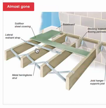

Strengthen existing joists
Regarding strengthening existing joists I found the following ways :
1) Sistering - problem with that is that existing joists are more than 6 meters long so it had to be a special order I guess and not the most cost effective way
2)Joist braces -seem the most cost effective way but not sure how effective it is ?
https://www.diynot.com/diy/attachments/screenshot_6-png.147357/
3)Any other suggestions

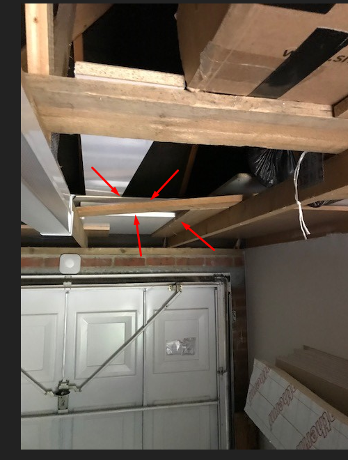

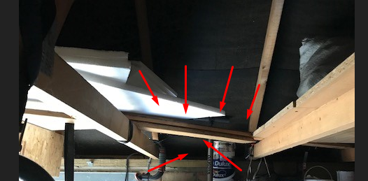

Also there are pieces of timber that travel laterally at the top and bottom of the garage and was wondering if they server a purpose or they can be removed (it would be harder to board it along with them in place)
Picture below:
Bottom:
https://www.diynot.com/diy/attachments/lateral-1-png.147358/
Top:
https://www.diynot.com/diy/attachments/lateral2-png.147359/
Finally any other recommendations in the order of tasks or anything else would be very welcome .
