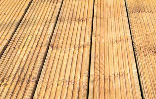

Timber decking and garden furniture can be oiled, stained or sealed. There are no hard and fast rules about which you should use, so it is really down to personal preference. We prefer to oil as it brings out the natural texture of the timber, but in certain circumstances this might not be appropriate or the most attractive thing to do.
Treated and cared for decking
Treat Decking to make it last and look great
Whichever approach you take, first it will be necessary to clean the timber and the easiest way to do this is with a power washer for decks (and some larger items of furniture) or a bucket of soapy water, a stiff brush and some elbow grease! A mop, bucket and good scrubbing brush is a great way to clean timber decking. See our power washing project for more information.

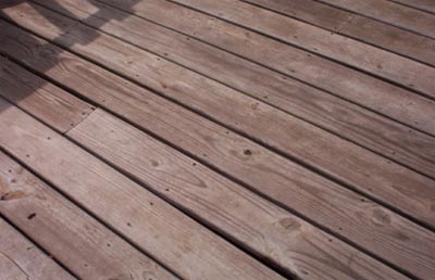

Most DIY stores these days have proprietary treatment products for decking and furniture and they are almost all derivatives of the following products. All can be used to treat and preserve the timber. The linseed oil is particularly good for hardwoods. Oil should be applied regularly, about 3 times per year, to get the very best out of your decking.
Treating Decking and Furniture with Linseed Oil
Linseed Oil in a very versatile and useful product. It is the extract of the flax seed and can also be known as Flaxseed. Not only is linseed critical to the proper seasoning of a cricket bat, it can also be used as a food additive or nutritional supplement (due to the high omega 3 fatty acid content). It has some be used as a paint binder, the oil in putty, the ‘glue’ for gilding and even the primary ingredient in traditional Lino flooring.
It is very safe to use and has an odour that most people enjoy. The linseed penetrates the wood and does not provide a surface barrier as a varnish would do. It also will allow water to penetrate and therefore can be prone to mildew, which is why we suggest treating the decking or wood with a universal preserver before applying the linseed. Linseed will not provide protection from scratches but it does show the grain of the wood and will weather over time to a very natural look which you cannot achieve with any other finish.
Weathered Decking finished with Linseed Oil
