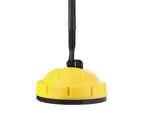

For cleaning large areas, consider using a Patio Cleaner attachment instead of the standard lance. This tool uses rotating jets to cover more surface area, cutting cleaning time in half.
Patio cleaner tool that can be used with a power washer

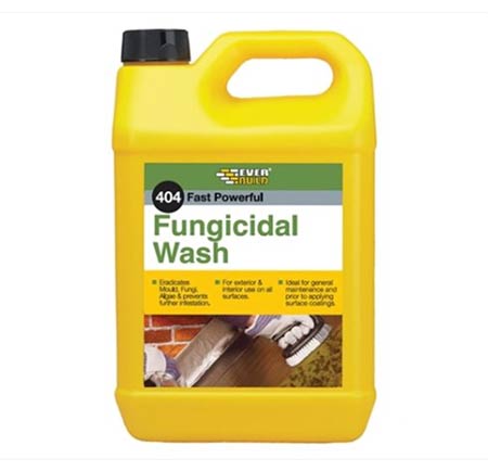

For best results, use a quality anti-fungal wash to pre-treat the surface. Products like Everbuild Fungicidal wash help break down algae and lichen, making them easier to remove with the power washer.
Everbuild Fungicidal wash for removing algae and lichen build-up

Before power washing, apply an anti-fungal treatment to tackle heavy algae and lichen build-up. Skipping this step might leave stubborn lichen embedded in the wood, making the power washer less effective. Pre-treatment helps loosen the algae and lichen, ensuring a deeper clean later.
Follow the manufacturer’s instructions for your chosen surface and treatment. We recommend using Everbuild Fungicidal Wash, which can be applied with a brush or a low-pressure garden sprayer for even coverage.

Using a patio cleaning attachment with your power washer can save time and effort. While some washers come with one, you can buy a separate attachment for around £50 if needed.
Patio cleaning attachment for power washer
Patio cleaning attachment for faster results
