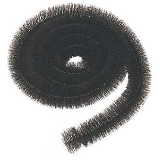

  • Gutter Brush or Gutter Hedgehog: These are the more common option in the UK and on the whole, certainly one of the better solutions. In essence it’s a long flexible brush that can be manipulated to fit almost any shape. It simply sits in your gutter and the bristles prevent any debris from entering but at the same time, doesn’t effect the ability for water to flow in. To keep the brush or Hedgehog in place special clips can be purchased that clip it to the gutter, preventing it from being blown out
  • Gutter brush or gutter hedgehog
