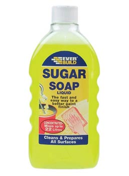

  • Next, get a bucket with some warm water and mix in some sugar soap and wash each of the doors and frame over making sure that you get into any and all nooks and crannies. The sugar soap will help to remove any grease and grime build up. Leave it to dry out thoroughly
  • Sugar soap
    Sugar soap of cleaning and degreasing/p>

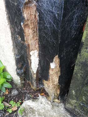

  • As we are dealing with timber there is going to be a good chance that may be some cracks, splits or rot. Firstly, remove any rotten areas using a scraper to dig it all out (if it’s really bad in places or is spread over a large area then you may need to consider more drastic repairs or even new doors or framework). With all the rot gone, use an external caulk or decent wood filler to fill all holes and then any cracks that may be present. Allow it to cure for manufacturer’s recommended times and then sand all areas flat if needed
  • Rot in frame of wooden garage door
  • Once sanded, stripped and repaired give all areas a good brush over to remove any dust and then a wipe over with a damp cloth and the sugar soap solution. Allow to dry completely.

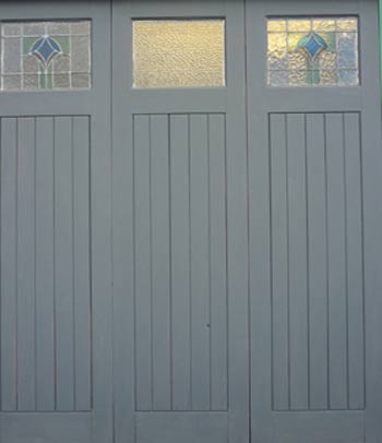

Primed wooden garage door
Wooden garage door primed and ready for top coat paint

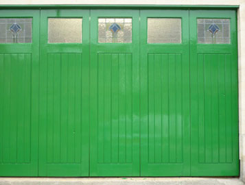

Wooden garage door with top coat paint
Wooden garage door finished with top coat paint
