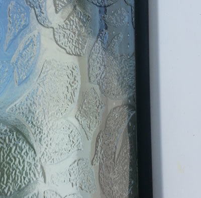

The same scraper can be used to scrape unwanted transfers from ceramic tiles. Once the transfers have been removed it is advisable to rub over the tile surface hard with a cloth dipped in white spirit. This should remove any remaining adhesive.
Paint splash removed from PVCu door glazing
