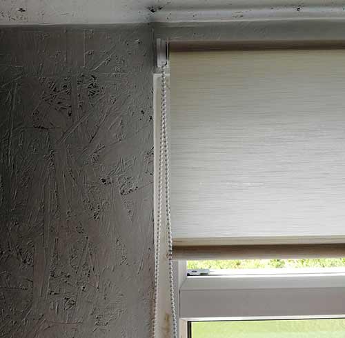

Measure, Mark, and Position the First Blind Bracket
To ensure your blind is centred and covers the window fully, measure and mark the exact position for the brackets before fixing them.
For our 1200mm blind over a 1200mm UPVC window, the frame added 50mm on each side, giving enough overhang to cover the glass. The window reveal was 1210mm wide, and the blind, including brackets, was 1200mm, so the brackets were positioned 5mm inside the reveal.
Measuring size of window reveal
Starting with the left bracket, measure and mark a point 5mm from the reveal edge. Position the bracket, level it, and mark through each fixing hole.
We fixed into a timber surface, screwing directly into it. For masonry surfaces, drill a 6mm hole, insert a red wall plug, and then fix the bracket (more information on fixing to masonry surfaces).
Drill a small pilot hole to assist with inserting screws. Tips on drilling pilot holes can be found in our project guide.
Once the pilot holes are drilled, screw the first bracket in place, using a spirit level to ensure it is horizontally square.
First roller blind bracket screwed in place

Fit the Blind and Test
With both brackets securely fixed, it’s time to install the roller blind and chain mechanism.
Insert the chain’s splines into the bracket carrier, ensuring the chain hangs correctly at the base for proper roller action.
Once engaged, slide the splines into the bracket, then insert the pin into the right-hand bracket, making sure it’s fully seated in the housing.
Secure the pin with the retainer clip to prevent the roller from dislodging.
Insert idle pin to hold roller in bracket
Inserting pin to hold roller in place inside bracket
Test the roller blind to ensure it operates smoothly. You’re done!
Roller blind fitted over window reveal
Roller blind successfully fitted over window reveal
