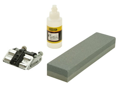

Use an oilstone to sharpen your chisels and, having laid a small amount of oil on the stone, place your chisel on at the correct angel. A honing guide can be used for this but these guides do not allow you to sharpen the chisel in a figure of eight pattern very easily.
The reason the chisel is usually sharpened in a figure of eight is that this allows you to use the full width of the sharpening stone and you do not wear away a groove up and down the stone.
It is important that every part of the chisel edge touches the stone at all times and this will come with practice.

Chisel sharpening set including honing wheel, oil and oil stone
