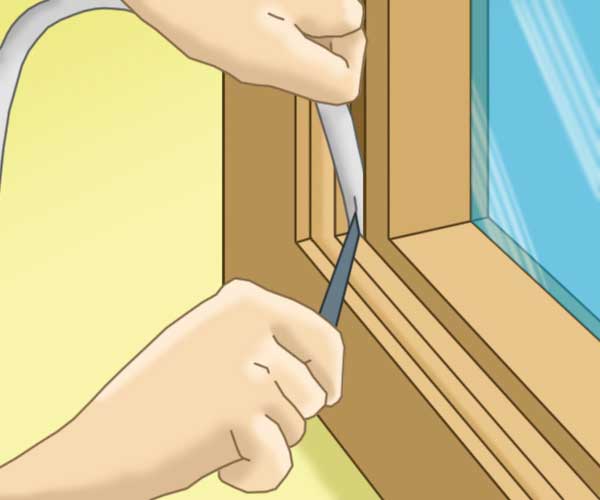

One product we have seen that is quite good is the sash window seal Gapseal. It is a flexible, non-permanent window sealer, which can be inserted at the onset of the cold time of year and removed in spring when the sash windows are used again. It can be used many times, does not absorb moisture and will bridge most gaps.
Trim the sash window sealer
Trimming up the sash window sealer
Push sealer into corners of Sash Windows
Push the sealer into the corners of the sash window
Push sealer between Sash Window halves
Push sealer between sash window halves
Application is fast and easy. The sealant is pushed into the gaps around the window with a handy applicator. The sealant stretches so that small gaps can also be successfully filled. Once inserted, the magnolia coloured seals are invisible to the eye. The seal will always try to expand to its original size, making it fill any gaps created through expansion or contraction of the wooden frames.
Fit sealer between Sash Window sections
Fit sealer between sash window sections
