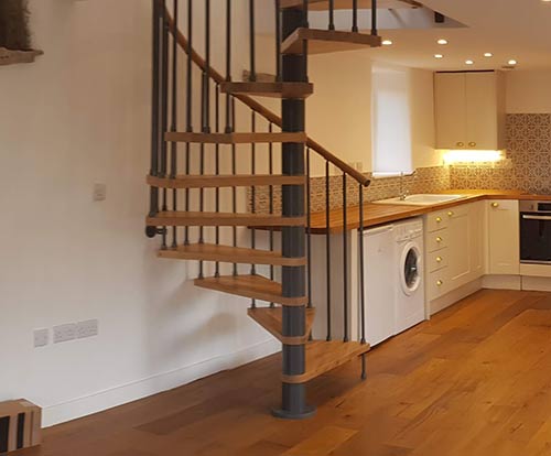

One final layout is a spiral staircase. These can look fantastic in the right location and are useful where space for a staircase is limited, but be aware that they are less easy for children and elderly people to navigate. They can also be challenging when you need to move furniture from one floor to another. This example (below) has been installed in a barn conversion that is being used for holiday accommodation.
Spiral staircase
Designed to make the most of a small space, this spiral staircase keeps the living room open
