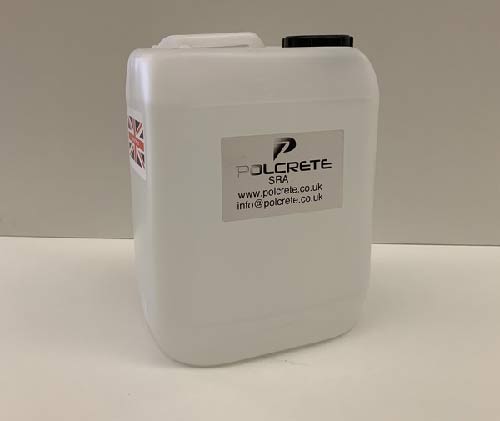

Shrinkage Reducing Admixtures
In most situations, a shrinkage admixture is added to a mix at the first stage of mixing with the main goal of helping to prevent both sort term and long term shrinkage. In essence, shrinkage can occur as a mix cures, as the moisture content of the mix reduces and also elements of the mixture settle, shrinkage can occur.
Additionally shrinkage can occur over a longer period, in this case many years. The introduction of a shrinkage inhibitor can also help to reduce long-term shrinkage affects.
However there is a slight downside as these admixtures have been known to actually reduce the overall strength of the concrete once cured.
Shrinkage reducing admixture

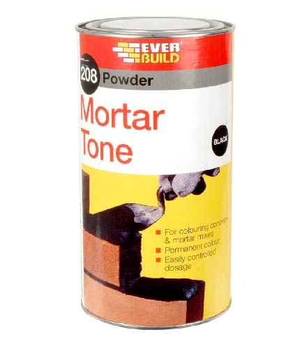

Concrete and Mortar Dyes
Concrete doesn’t always come in grey, it can come in a range of different colours, sometimes these are dictated by the types of materials used e.g. the colour and shade of sand, aggregate etc but it can also be coloured using special dyes.
Available in a whole range of different tones and colours including black, brown, yellow and many more, the required quantity of dye is added to the mix and the mixing stage to create the required colour.
Getting the exact shade of your chosen colour is essentially a process of trial and error and once you do arrive at your required colour ensure that exact quantities are all marked down using the “table of quantities” table mentioned in the matching mortar project above.
Concrete or mortar dye

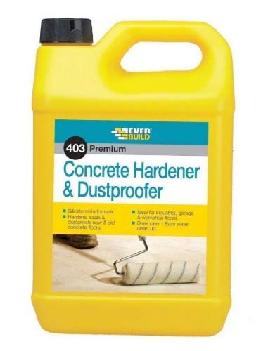

Dustproofers
Although not technically an admixture e.g. it doesn’t get mixed in with concrete to become part of the mix, dustproofer (often called hardener and dustproofer) is applied to existing or newly laid concrete surfaces so it’s worth a mention.
With freshly laid concrete surfaces, once the concrete has cured it leaves a fine film of dust on the surface which, when finishing a job, can cause havoc with freshly painted surfaces and the like.
Applying a coat of dustproofer to such surfaces can seal it and prevent this dusty layer from causing any issues.
Likewise, with older concrete surfaces, they are subjected to wear and damage that in turn can release dust particles that can easily find their way up through carpets and similar coverings and get into room spaces. Coating older surfaces with a dustproofer can significantly reduce these issues.
Concrete hardener and dustproofer
