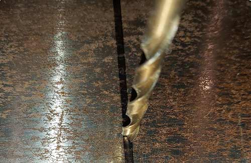

Using a Drill
If you are without the go-to solutions for cutting metal such as an angle grinder or hacksaw it is possible to cut metal using a power drill.
To do so simply insert a medium sized drill bit into the drill, around 6mm or so and then drill along or around your cutting line ensuring that every hole butts up to the next. Once complete you should then be able to repeatedly bend the item up and down until it breaks off.
The downside to this method is that you have a lot of tidying up to do in that all of the half semicircle drill holes need to be filed down flat and smooth, not an easy job.
This method of cutting metal should really only be used when there is no other choice and due to this it’s really limited to cutting sheet metal, probably no more than 6mm thick.
Cutting sheet metal using a drill

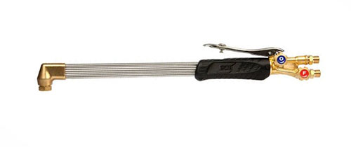

Oxy-Acetylene Cutting Torch
The oxy-acetylene cutting torch looks more like a traditional welding torch for those of you familiar with these items and using the correct torch the gas can certainly be used for welding and joining metal together.
The difference comes in the way that the gas is used. When welding the oxygen and acetylene are combined and mixed using the torch to produce a flame hot enough to weld metal (effectively melting it together).
The difference with the oxy-acetylene cutting torch is that, firstly is does exactly the same as a welding torch as can heat metal to melting point but it also features a handle, that when squeezed, shoots a jet or pure oxygen onto the cutting area super heating it and blowing the melted metal away at the same time.
The oxy-acetylene torch can be used to cut any metal object of pretty much any size but as you are dealing with extreme heat, the dangers of using this tool are great so the correct PPE must be worn at all times. This also includes a special helmet to protect your eyes from the extreme brightness of the flame.
