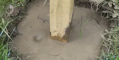

Fence post correctly set in ground
Fence post correctly set in ground using Postcrete
