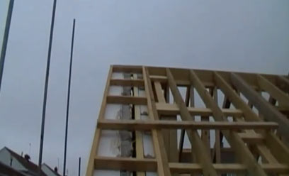

Being eligible for permitted development essentially means that you do not have to apply for full blown planning permission and can create certain structures without it.
In this guide we run through all the essential points of permitted development, highlighting exactly what you need to know.

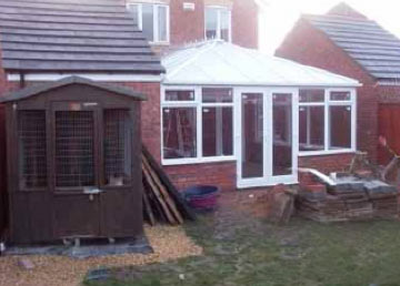

Conservatory and Permitted Development
Building a single-storey conservatory under permitted development is allowed, but certain conditions must be met. If any of these apply, you will need planning permission.
For the full list of conditions, download the guide to conservatories under permitted development. Common conditions include:
  • On designated land (conservation areas, natural beauty spots, or world heritage sites), the conservatory cannot be clad with materials like render, plastic, tiles, stone, or pebbledash.
  • If on designated land, the conservatory must not extend beyond the side wall of the house.
  • The conservatory footprint, combined with other extensions, sheds, or outhouses, must not exceed 50% of the land around the original house.
  • The conservatory must not be wider than half the width of the original house.
  • It must not exceed 4m in height.
There are additional conditions, so be sure to review the full guide on conservatory permitted development to see how they may affect your project.

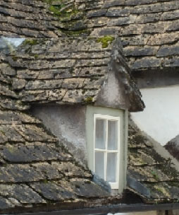

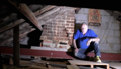

Loft Conversions and Permitted Development
Loft conversions are allowed under permitted development as long as specific conditions are met. If these conditions apply, planning permission will be required.
Here are some key conditions. For the full list, see the Planning Portal guide on loft conversions:
  • The total loft space must not exceed 40 cubic meters for terraced houses or 50 cubic meters for detached and semi-detached houses (including any previous conversions).
  • Permitted development does not apply if the conversion extends beyond the existing roof slope facing a highway.
  • No part of the conversion should overhang the outer face of the original wall.
  • If bats are present, special protection rules apply, see our project on planning permission for full details on this.
These are common conditions, but be sure to review the full guide to avoid costly errors. Note, permitted development only applies to houses, not flats or maisonettes.
Loft conversion and chimney stack removal
Removing the chimney stack for a loft conversion

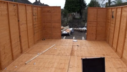

Outbuildings (Sheds, Workshops, Garden Stores, Pools, Saunas, and More)
Outbuildings, including sheds, workshops, pools, hot tubs, and tennis courts, fall under permitted development, as do enclosures for fuel tanks or pet housing (e.g., aviaries, hives, and livestock shelters).
Below are some common conditions where permitted development may not apply. For the full list, download the Planning Portal guide on outbuildings.
  • No outbuildings are allowed within the grounds of a listed building.
  • Outbuildings cannot be in front of the main house elevation.
  • They must not cover more than 50% of the original property grounds, similar to extension rules.
  • Outbuildings must be single-storey, but height restrictions apply, see the guide for details.
  • Decking and platforms must follow specific conditions outlined in the guide.
  • These rules apply only to houses, not flats or maisonettes.
Permitted development outbuilding
Outbuildings can be built under permitted development

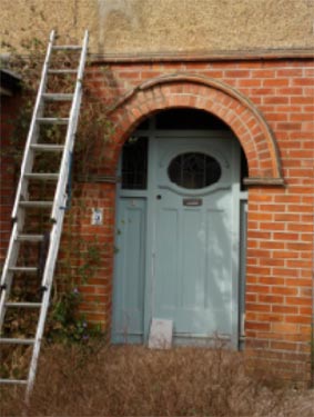

Porches and Permitted Development
Building a porch is generally allowed under permitted development, unless certain conditions apply.
Below is a brief summary of the key conditions. For the complete guide, download the Planning Portal guide on porches.
  • The porch covers more than 3 square metres.
  • Its height exceeds 3 metres.
  • It’s within 2 metres of a boundary next to a road.
Brick archway to permitted development porch
Porches can be built under permitted development
Note: These conditions may not apply in areas with Article 4 restrictions. Always check your responsibilities on the Planning Portal.
