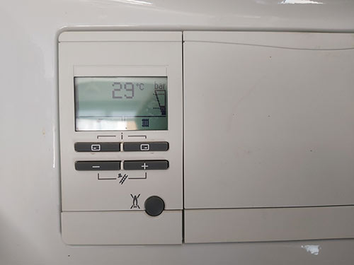

Low Boiler Pressure
If you have ever inspected your boiler you may have noticed that it has a pressure gauge, this will either be a circular analogue gauge with a needle that points to the pressure the boiler is currently at or a digital gauge displaying the boiler pressure in bar.
The pressure reading that’s displayed indicates the current pressure of the hot water in the central heating system.
For the system to work correctly the pressure needs to be at least 1 bar and ideally around 1.5 bar but this can depend on the type of boiler (manufacturers instructions will state ideal operating pressures).
If however the system drops below 1 bar of pressure then it simply won’t work correctly and will either shut down or display an error on the LCD screen (if there is one).

LCD boiler pressure read out on front of boiler
