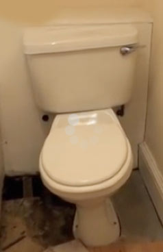

Condensation on and under toilet cisterns can cause huge unseen problems. The warm air in the bathroom hits the underside of the toilet cistern and cold water pipes and condenses causing condensation immediately.
This condensation then drips on to the floor and once the floorboards are wet and then eventually soaks down into the joists, over time the whole lot rots and then the floor collapses.
Once this has happened you then have no choice but to replace all the floor boards, joists, floor coverings and often the ceiling below at great hassle and expense.
One other issue that we have seen in recent years is that the modern trend of burying the toilet cistern out of site, often behind a stud wall to create a more minimalist look, but this can cause huge problems due to the issues outlined above.
While this makes the whole bathroom look much neater and tidier, but if the cistern or indeed any cold water pipes running to it are not insulated, then the same condensation issues can occur, only this time out of sight so you have no idea they’re actually happening until the floor collapses.

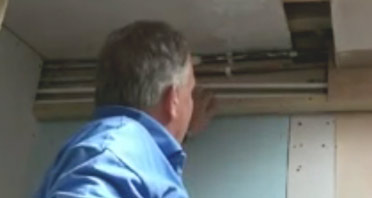

Boxing in Pipes
Pipe boxing to keep cold water pipes warmer
Use boxing and insulation to warm cold water pipes
If the condensation problem exists in your bathroom or toilet, boxing in the pipes where ever possible can help. This might warm the water going into the cistern slightly allowing less condensation to form.
Before any boxing in is done, make sure you lag the pipes and/or place insulation inside the boxing also to help keep as much warmth in as possible. You can find out more about pipe boxing in this project.
And if you want to know how to lag your pipes correctly, see our pipe lagging project here.
The hot humid air from the room condenses on the colder water pipes and underside of cistern so any insulation you can use will make things better.
Boxing on it’s own however can be dangerous as you can no longer see the condensation forming so as said, don’t forget to insulate as well as box in the pipes.

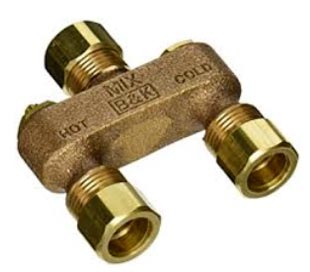

Adding Hot Water to Your Toilet Cistern
There are fittings available in the US called anti-sweat valves which can add a little hot water to your cistern when the cold water enters after you have flushed.
Warming the cistern water will reduce condensation
Anti-sweat valve for adding warm water to toilet cistern – Available form Amazon here
On the whole this isn’t a great solution, as I’m sure you can imagine, as it can be expensive and if it is a loo which is not used often, can be a complete waste.
Also, as the warm water cools very quickly when introduced to the cold water, condensation can then still form. With this in mind this option is best avoided, but for completeness, we have to mention it.
However if you do fancy trying this then the anti-sweat valve can be achieved by connecting your hot water basin or bath supply to the water feed as it enters the cistern.
The hot feed should be controlled by an in line service valve (such as that used on a washing machine hose) which will allow you to turn down the amount of hot water mixing with the cold as it enters the cistern.
Service valve for adding hot water to cistern
Add hot water to toilet cistern via a service valve

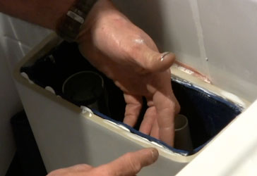

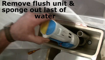

Step 3 – Clear out the Cistern
As we have said above but if you haven’t done it yet, flush the cistern to remove as much water as you can then, and using a sponge or rags etc., wipe out the cistern until it is completely dry. Then use a hairdryer to warm up the inside.
You can strip out the contents of your cistern, or simply work around them, but in all honest it is easier to remove everything, so you have some space to work in.
Remove any removable parts, such as the flush unit from the cistern. These can easily be refitted after your mat is in place.
Removing flush unit from toilet cistern
Get to the cistern parts by removing the flush unit
It’s also an easy job to remove the cistern from the toilet entirely. This will make it much easier to work on. Simply disconnect the incoming water supply pipe and then the two nuts that attach the cistern in place underneath either side of the back of the toilet bowl.

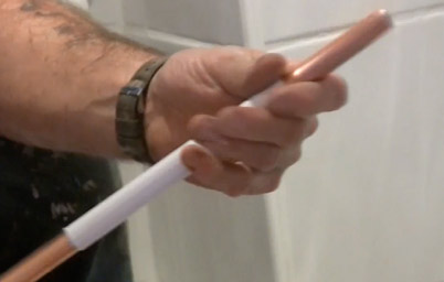

  • Method 2 takes up a lot less room but is not quite so effective. It is however, considerably more attractive! The tubes in the image are called pipe snaps and they are pre-curled strips of plastic which can be cut to length easily as shown in the video. They simply clip over the pipe and make it just a touch warmer and less prone to condensation
Warm and hide copper pipes using pipe snaps
White pipe snaps to hide and warm copper pipe
