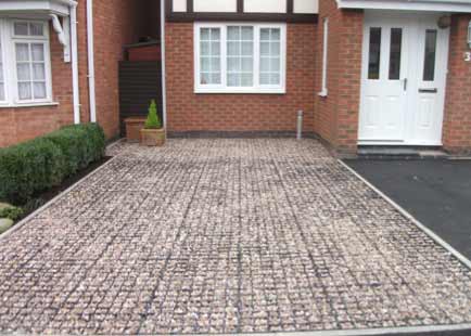

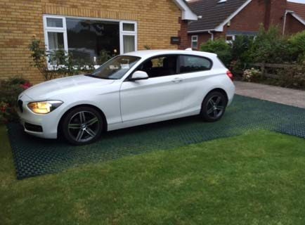

Reinforced Grass Driveway and Parking
These are either plastic or concrete grid systems, set down into the ground or led on top that reinforces it, stopping your wheels creating ruts but allowing the grass to grow between the mesh. Plastic systems can also be used to stabilise a gravel driveway (see below) and stop the gravel spreading away from the driveway.
They are easy to install and look very natural once the grass is established but you will need to use the recommended grass species that will grow up through the mesh. While this is the most natural looking and eco-friendly solution, it does require maintenance such as mowing.
If gravel is used this will need to be swept back in to the mesh on occasion, especially on sloping driveways.
On the whole, grass driveways are not really suitable if you car is parked there all the time as the lack of light will kill the grass. Also during the colder, damper months of the year, excess water can make the ground boggy causing your wheels to spin which will chew it up further.
A plastic grid system used for a reinforced grass driveway
A plastic grid system used for a reinforced grass driveway – Image courtesy of Driveway Grid Systems

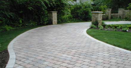

Permeable or Porous Hard surfaces
There is a wide range of permeable surfaces that allow the water to pass through while still providing a sound hard surface for driving and parking on. Porous asphalt, concrete and block paving either allow the water through the material or around the edges of the blocks, however they have to be built on a porous sub-base.
Surfaces such as these are very durable and require a minimal amount of maintenance and the bonus is you will still have the look and feel of a normal paved area.
The choice of materials, styles and finishes for such hard standing surfaces is huge, with a finish sure to suit any tastes.
The one big drawback with hard standing surfaces such as these is that the construction in more complex and therefore much more expensive and you will likely need a contractor that has experience in laying such structures – which you can find here.
Porous paved driveway
A porous paved driveway – Image courtesy of Minster Paving

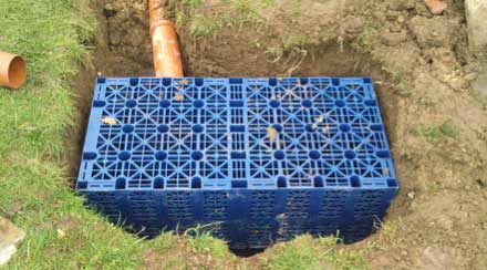

1. Using a Soakaway to Absorb Excess Water From Your Drive
A soakaway is essentially a large hole in the ground which is filled with large and course aggregate where rain water collects and then slowly seeps away down into the soil.
We have a whole project on the construction of a soakaway, so we will not get into it here, but see the project for full instructions on how to build one.
The advantage of a soakaway is that it is relatively cheap and easy to construct and can, in the right conditions, absorb significant amounts of excess water.
While the construction is relatively easy, it is a significant project which requires the excavation of a very large and deep hole. If not constructed properly they are not as effective and can even make issues worse!
One point to note is that you cannot use a soakaway if you have a clay soil (clay, silty clay or sandy clay) as the water simply fails to drain quick enough and can cause huge issues down teh line.
Soakaway to allow drainage
A new soakaway to allow rainwater to soak into the soil

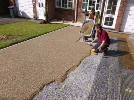

How Permeable or Porous Driveways are Built
The driveway will need to be dug out and then built back up to the desired surface level. The depth you need to dig out the driveway does depend on the local conditions; if the soil is loose and will not provide a firm base you will need to dig out more to provide a deeper sub-base to ensure stability.
As a rule of thumb, if you can drive a 150mm (6 inches) peg into the ground then it is not strong enough to support your driveway and will need digging out until you hit a firmer, more solid base.
Building up base for resin driveway
Building up the driveway from a sub-base for a resin driveway – Image courtesy of Sureset

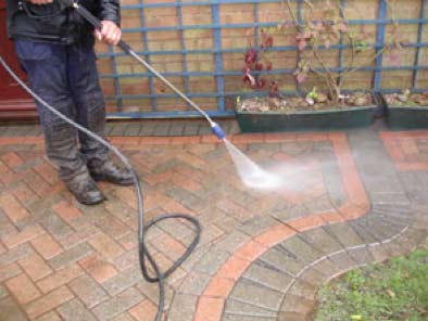

Maintenance Consideration for a Permeable Driveway
The precise maintenance required for a driveway will ultimately depend on the type or driveway you have, but there are a few important rules of thumb that you can follow to ensure that it continues to work well.
The key thing to remember is that they work by allowing water to pass through them and soak away into the soil below. For this to happen there needs to be gaps and pores for the water to travel through, so these should not be allowed to become blocked up.
Therefore your maintenance of a permeable driveway should include:
  • Clear any leaves or mud that collects on the driveway – this can break down and pass through the surface and block the pores
  • Brush away any dirt or dust that collects on the surface or use a pressure washer
  • Remove any weeds, rather than using a weed killer as the weed can then rot down and block the pores
  • Don’t put any materials, like sand, cement or oils on the surface of the driveway which could reduce the porosity
  • Ensure that soil and dirt for the garden are not washed onto the driveway
If you understand how they work it is easy to understand what needs to be done to ensure that you permeable driveway remains permeable and porous and in tip top working condition.
